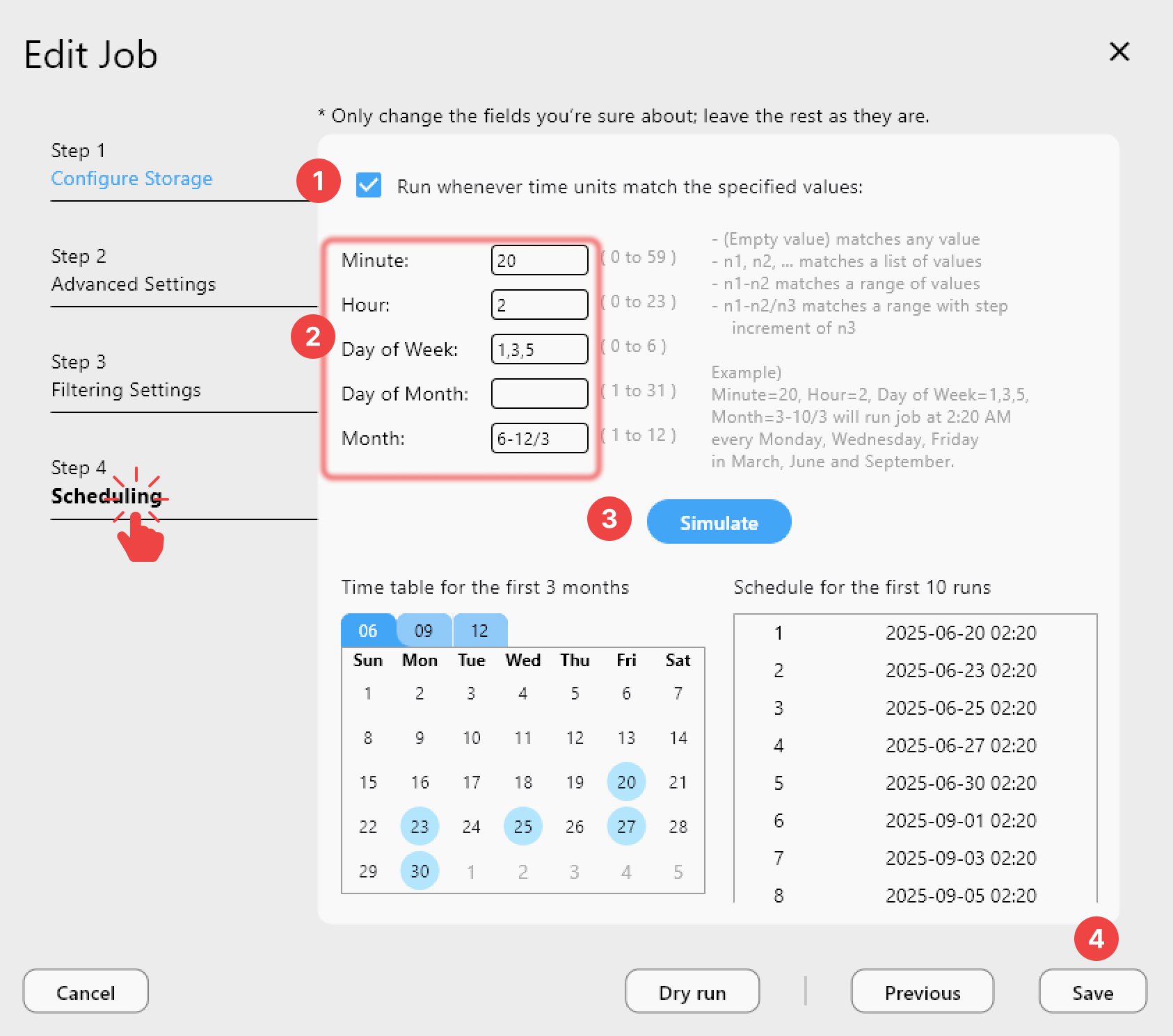

How to Schedule a Job​
  1. Check the box labeled Run whenever time units ~ to enable scheduling.
  2. Set the desired repeat schedule using the Time and Date fields.
  3. Click Simulate to preview when the job will run.
  4. After confirming the schedule is correct, click Save.

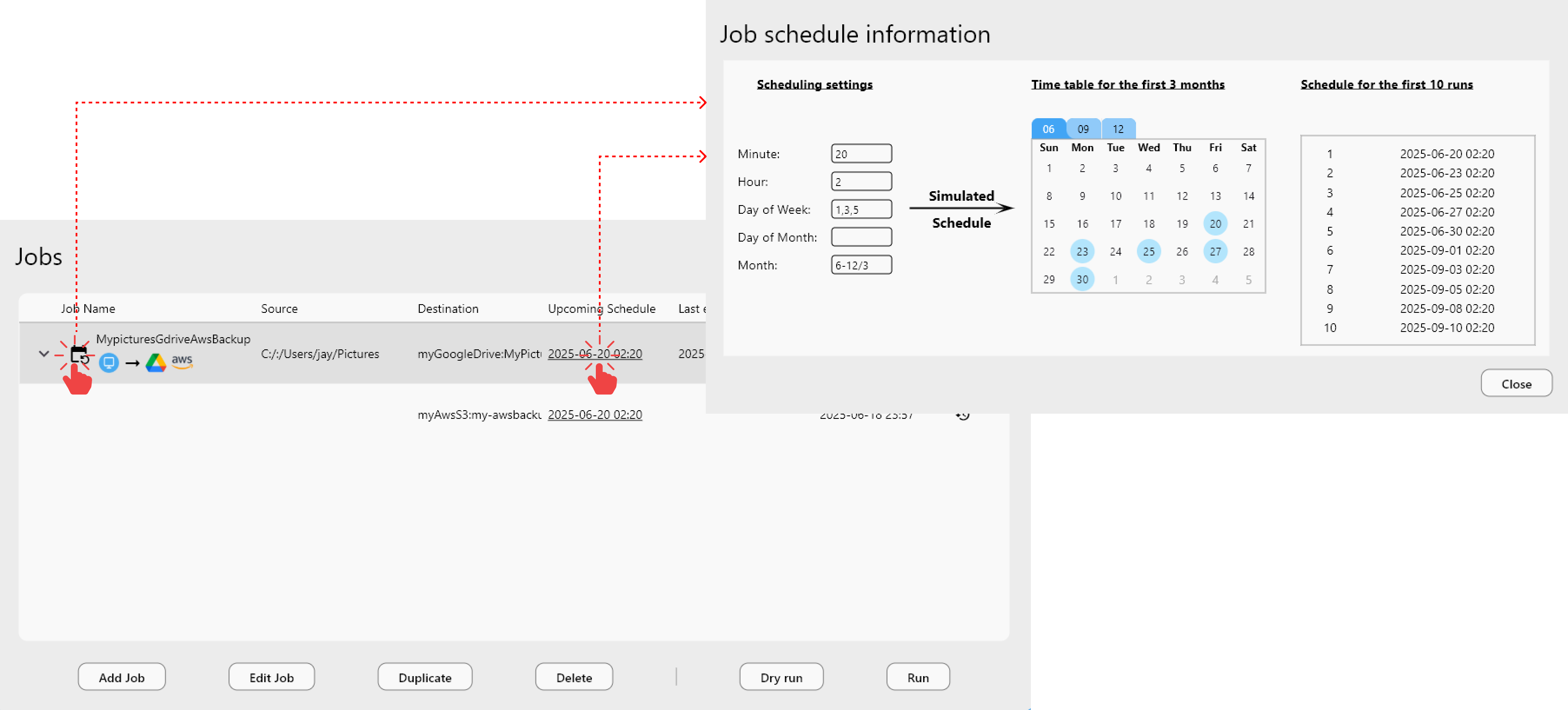

Once saved, click the calendar icon calendar icon or the scheduled date under Upcoming Schedule to visually review the configured execution times.
verify job schedule

The schedule configuration supports Crontab-style values, allowing for precise and flexible scheduling to meet a wide range of user needs.
Field NameAllowed ValuesDescription
Minute0-59Minute of the hour
Hour0-23Hour of the day
Day of Week0-60 = Sunday, 1 = Monday, …, 6 = Saturday
Day of Month1-31Day of the month
Month1-121 is January, 2 if February, and so on.
Accepted Formats:
  • Empty value : Matches every unit (e.g., every minute if Minutes is blank).
  • n1, n2, ... : List values (e.g., 1,3,5 for Monday, Wednesday, Friday).
  • n1-n2 : Range of values (e.g., 0-2 means 0, 1, 2).
  • n1-n2/n3: Range with step (e.g., 6-12/3 means 6, 9, 12).
The fields — Minute, Hour, Day of Week, Day of Month, and Month — work together using a logical AND operation. This means the job will run only when all conditions are met.

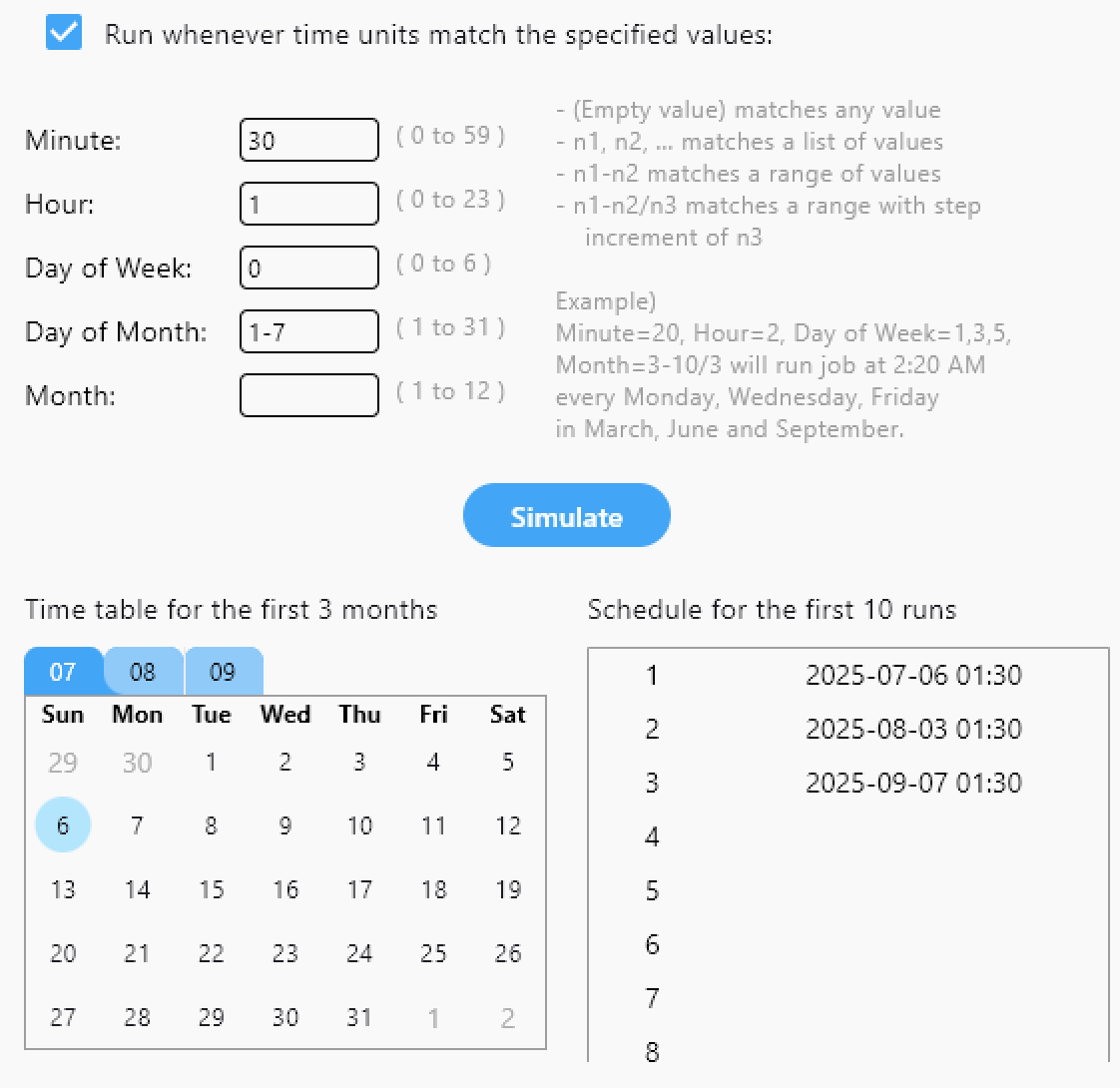

📌 Example: Running a sync job at 1:30 AM on the first Sunday of every month. To achieve this schedule, configure the following fields:
  • Time (1:30 AM):
    • Minute: 30
    • Hour: 1
  • Date (first Sunday of each month):
    • Day of Month: 1-7 — matches the first seven days of the month
    • Day of Week: 0 — where 0 represents Sunday
    • Month: Leave blank — applies to all months
✅ This combination ensures the job runs only when the date is within the first week and falls on a Sunday, effectively scheduling it for the first Sunday of each month at 1:30 AM.

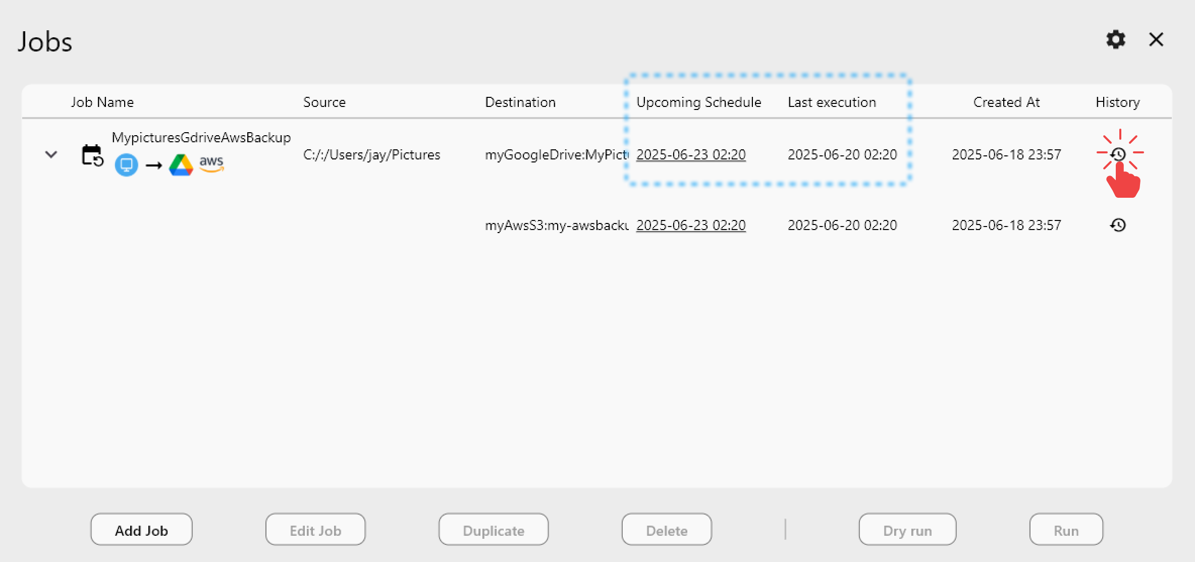

Check Job Scheduling Results​
View Execution History in the Job Manager​
You can verify both the most recent execution time (Last execution) and the next scheduled run (Upcoming Schedule) in the Job Manager window.
open job schedule history

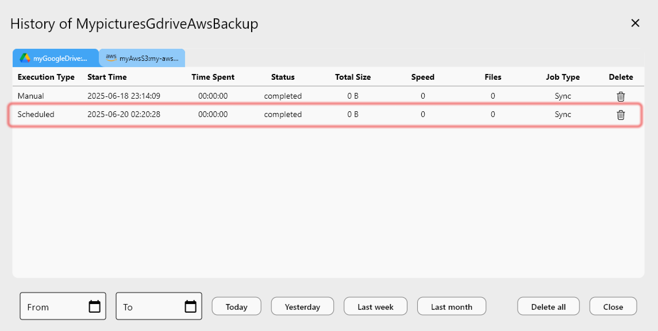

To view details of execution history of the job:
  • Open the Job Manager.
  • Click the history icon history iconto open the job execution history for the selected job.
In the Execution Type column, entries marked as Scheduled indicate that the job was triggered automatically by the scheduler.
view history of scheduled job
Verify the Logs for Multiple Destinations
If your job includes multiple destination remotes, click on each destination tab individually in the History view to review the log details for each target.
