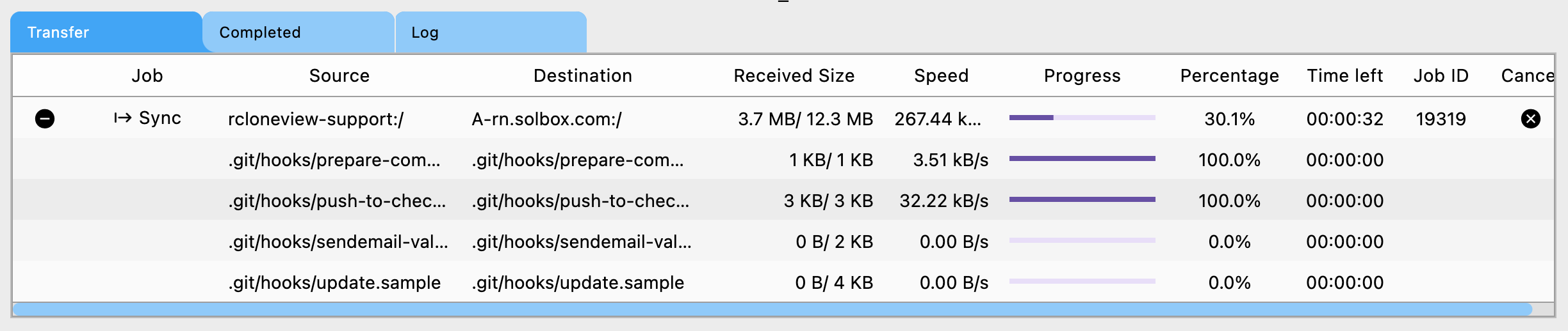

Transfer Tab - Ongoing Jobs​
transfer log
This tab shows all currently active file transfer jobs.
Columns:
  • Job: Indicates the operation type (e.g., Sync, Copy, Delete).
  • Source / Destination: Displays the origin and target path.
  • Received Size: Amount of data transferred / total size.
  • Speed: Current transfer speed.
  • Progress: Visual progress bar of the current job.
  • Percentage: Transfer completion percentage.
  • Time Left: Estimated remaining time.
  • Job ID: Internal ID used to reference this job.
  • Cancel: Click the ❌ icon to cancel the job in progress.

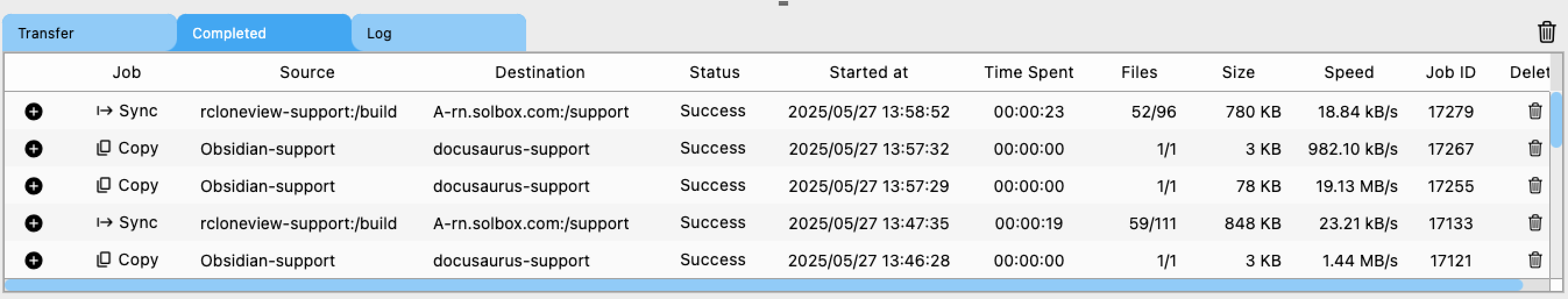

Completed Tab - Job History​
completed log
This tab lists all previously executed jobs and their results.
Columns:
  • Job: The operation type (Sync, Copy, Delete, etc.).
  • Source / Destination: Path of the source and destination.
  • Status: Result status (e.g., Success, Errors).
  • Started At: Start time of the job.
  • Time Spent: Total duration of the job.
  • Files: Number of files transferred.
  • Size: Total data size.
  • Speed: Average transfer speed.
  • Job ID: Internal job reference.
  • Delete: delete files icon to remove the record.

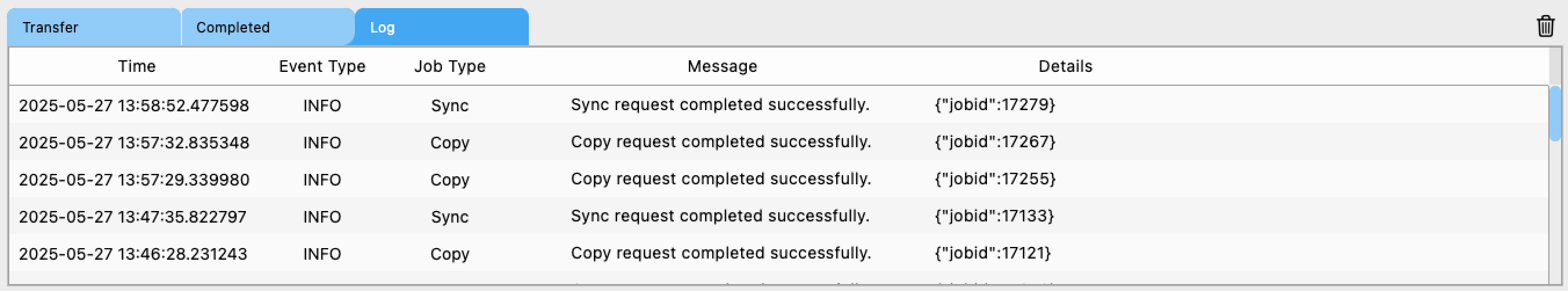

Log Tab - API Communication Logs​
log tab
This tab displays backend logs from RcloneView's communication with the Rclone API.
Columns:
  • Time: Timestamp of the operation request.
  • Event Type: Log level (e.g., INFO, ERROR).
  • Job Type: The operation type (Sync, Copy, Delete, etc.).
  • Message: Result of the operation.
  • Details: Additional internal metadata (e.g., job ID in JSON).
Use this tab for troubleshooting or reviewing system-level interactions.
