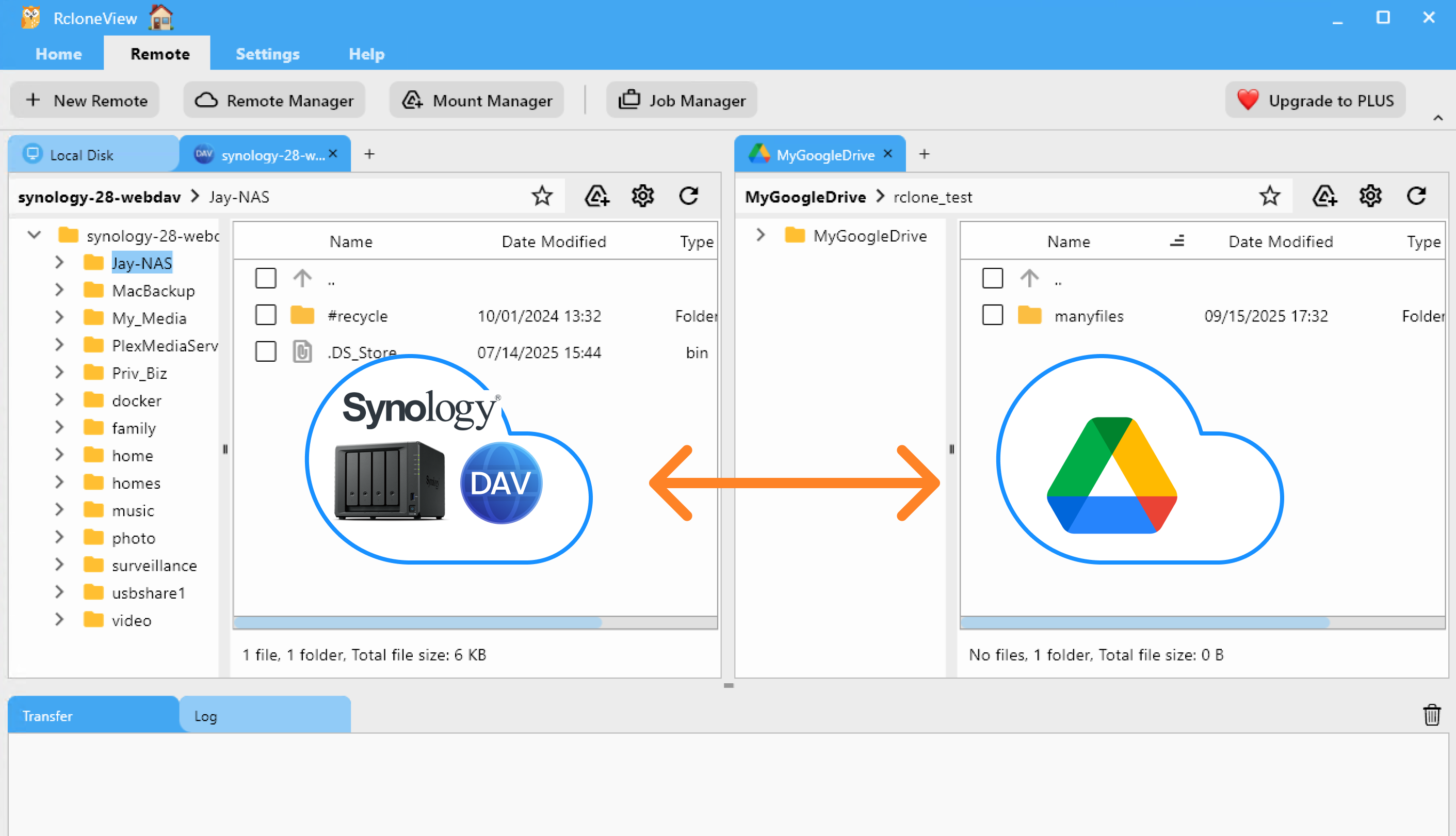

Step 2 – Wire up the connections in RcloneView​
RcloneView wraps rclone’s configuration in a guided, click-through flow.
  1. Open RcloneView → click + New Remote
  2. Add your cloud drive
    • Google Drive: OAuth sign-in → name it (e.g., MyGoogleDrive)
    • OneDrive: OAuth sign-in → name it (e.g., MyOneDrive)
    • (Others supported by rclone can be added similarly)
  3. Add your Synology NAS target using one of the following:
    • WebDAV: endpoint from Synology WebDAV Server, credentials → name it (e.g., MyNAS-WebDAV)
    • SMB: NAS hostIP, port, account → name it (e.g., MyNAS-SMB)
    • SFTP: NAS hostname/IP, port, account → name it (e.g., MyNAS-SFTP)
  4. Confirm both appear side-by-side in the Explorer pane.
